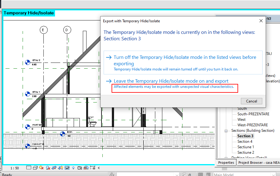

constantin.stroescu
maybe all this happens because you made the Export from a  View with a Temporary Hide/Isolate setting...
Have a look at this message when you Export from a Temporary Hide/Isolate:
There is a warning for possible unexpected visual characteristic..
  • So , either choose Apply Hide/Isolate, or Reset Temporary Hide/Isolate.
  • If you apply Reset , see if you have not a Masking or Fill Region in that place or other entity that could block the view..
Constantin Stroescu
