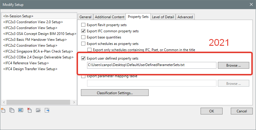

There is an issue with IFC export.
When I try to export IFC file with the option "Export user-defined property set" enabled, 2021 does not even try to export IFC, whereas in 2020, the same file, same options, exports successfully.

Nachricht 11 von 34
angel_velez
als Antwort auf: baris
Hello all, there is a workaround for this.  There is a missing DLL in the Revit 2021 install (which will clearly be fixed in an upcoming update).  In the meantime, you can do the following: Get IFC 2020 from the App Store and install it.  When you do (or if you already have it), search for GeometryGymIFC.DLL on your computer.  Copy/paste it into the Program directory for Revit 2021.  This will get the option to work.
I apologize for missing this in the install, and the open source update will also fix this problem.

baris
als Antwort auf: angel_velez
Thank you, dear Angel,
This workaround solved both problems:
  • Now I can define user-defined parameter sets
  • and Revit exports IFC file so much faster

Nachricht 15 von 34
angel_velez
als Antwort auf: milan_nemec
I believe we are preparing better notes for what to do - I am unsure if we can just post the DLL here.  Here is the preview, though:
  1. Download IFC 2020 from the Autodesk App Store.
  2. Browse to the following folder: C:\ProgramData\Autodesk\ApplicationPlugins\IFC 2020.bundle\Contents\2020
  3. Find the file GeometryGymIFC.dll.
  4. Copy the GeometryGymIFC.dll file and paste into the Revit 2021 program folder (e.g. C:\Program Files\Autodesk\Revit 2021).
Please try that.
