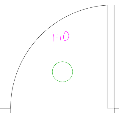

Hi all,
I am trying to print-to-PDF, in Vectors (yes I checked and made sure it was Vector NOT Raster before Printing to PDF), but the result gives me an extremely jagged Vector line instead of the smooth ones like on Revit's Screen BEFORE printing to PDF... ON revit workspace all the curves looks extremely good...
On Revit model:
After Printing-To-PDF:

Share the actual PDF file. What PDF printer are you using?

If you zoom into the drawing and print 1:10, 1:20, 1:50 ad 1:100, does it give the same result? Most often it is base on your DPI resolution. Normally I keep it 300-600 DPI to make those lines look smooth.
Message 12 of 17
curtisridenour
They are vector prints. I changed pdf printer and changed the DPI to 1200 just in case it was something strange. I tried printing to Raster as well. Nothing seems to help. I think the a different forum post https://forums.autodesk.com/t5/revit-architecture-forum/help-revit-does-not-produce-smooth-vector-cu... explains that it is a limitation of certain sizes of curves for Revit to draw. But I could easily be wrong. I am trying hard not to notice/care about it. 6" diameter circles aren't really of consequence on 1/8" (1:96) sheets I guess.

Did you try to use some other PDF printers such as Adobe PDF? It works well to me.

this is with Microsoft Print to PDF, PDF24 and BlueBeam. I do not have Adobe. All are set to 1:200 and printed at 100% Presentation settings. They all look the same.
