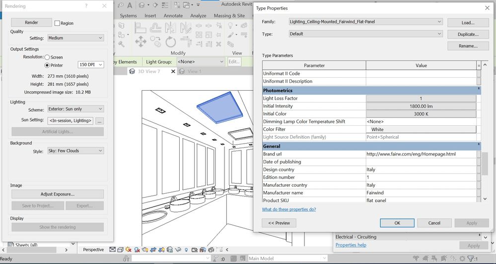

merhabalar.revitte render aldıgımda tamamen sıyah ekran ıle karsılasıyorum.neden sıyah ekran aldıgımı çözemıyorum yardımcı olur musunuz?

feel around the door jamb - about 4'-0" AFF - for the light switch. Turn it on.
Message 3 of 17
...joking aside, you've not given us much information here to work with.  What else can you share?

Okay. So what happens when you press "Render"?  Or have you gone that far yet?

It only gives the black screen in the background after the render time expires.

I don't know what to tell you. It looks like you are Rendering an indoor scene with Exterior: Sun Only and a bunch of missing  Appearance Images.   What do you expect?   GIGO.

no, the project is an indoor restaurant.
My illumination is not complete yet, but I encounter the same problem in places where they are complete.
I changed the revit version and I cannot get it from the area where I was able to light render before.

Take it one step at a time and isolate the problem
  • If you go to Rendering Dialogue >>> Artificial Light ...are the lights still there and switched on
  • If you go to Rendering Dialogue >>> Adjust Exposure ... Slid the dial to make it brighter, how would it look like the render
  • Are you using the right type of lights do they have a Photometric Web File assigned & Light Source defined
Lights and Light Groups existLights and Light Groups exist
Check ExposureCheck Exposure
Lighting Fixture IES & Light SourceLighting Fixture IES & Light Source

yes they are defined.
I checked the steps, the only problem is the artificial light button is not active so it does not detect the light by the way, thank you very much.

Check what @barthbradley told you earlier...You are rendering Exterior Sun Only... Select Sun and Artificial >>> Render >>> then adjust exposure if it is black or too dark

Yes, my problem was solved thanks to the solutions you provided. Thank you very much.
