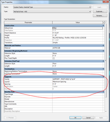

Ok, sorry for the delay.
There are two main ways to use the railing system. You can use the options under the construction section[Rail Structure (Non-Continuous) and Baluster Placement] or you can use the Top Rail, Handrail 1, and Handrail 2(you can use these in combination, but they act differently.)
In this case you want to use the Top Rail. You will need to create a new rail type or modify the existing one. Add your profile and fiddle with the settings until it works as intended.
Next create your support family. There is a railing support family template. It will be hosted on the top rail. The height of this family is not dynamic, but you can control it with a instance or type parameter, whichever you prefer. Be sure to add a width parameter as an instance so you can control it how you want.
Below are some screenshots.
