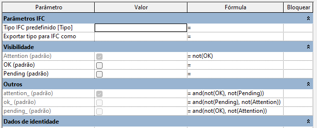

Hi Everyone,
I wanted to create a formula with 3 visibility parameters and it would only allow the selection of one item at a time (deselecting the others).
For example,
If Attention Checked, not (OK) not (Pending)
If OK Checked, not (Attention) not (Pending)
If Pending Checked not (OK) not (Attention )
try this, but not work for me.
https://www.autodesk.com/br/support/technical/article/caas/sfdcarticles/sfdcarticles/PTB/Set-yesno-f...
Any help or suggestions will be appreciated.
Thanks in advance.

Message 2 of 14
RC_RVT
So you need 3 yes/no parameter that can be adjusted like you have. These are not assigned to anything because they could be done wrong by the user.
You then have 3 yes/no parameters, (attention_, ok_, pending_) that are assigned or are essentially the correct/working parameters, if that makes sense.
You cannot use your formulas you have put in.
Use the following formulas for each parameter you have:
Attention = and(not(OK),not(Pending))
OK = leave empty as you have done
Pending = leave empty as you have done
attention_ = Attention
ok_ = and(OK,not(Pending))
pending_ = and(Pending,not(OK))

Message 5 of 14
Your formulas are running in circle.  For more than 2 parameters, use Integer instead of Yes/No.
1 = attention
2 = ok
3 = pending
Message 6 of 14
RC_RVT
Yes, like I said these are the face value options, in the background the "actual" yes/no parameters will control this as they will only turn on if the correct boxes are ticked. I don't know what you are using these for, but I use them all the time in families I create, and yes you can select the wrong boxes, but the background parameters keep this all controlled. If you are only using this for selection purpose and it's not controlling a family, use an Integer as ToanDN has said.
if you want to use these parameters as you have shown, use the following which I have adjusted:
Attention = attention_
attention_ = and(not(ok_),not(pending_))
The attention_, ok_ & pending_ parameters will control the model so that if both OK & Pending are ticked, as you have said, attention_ & Attention will automatically tick therefore highlighting that there is an issue.

nozci
This can't be done more than two parameters. Basically, what you want is radio buttons but this requires a parent class controlling checking status of the buttons like 1 2 3 which brings you to Toan's solution.
There is no such mechanism in Revit as far as I know, may be internal but not to the user.
Message 14 of 14
TripleM-Dev.net
Like @ToanDN mentioned , if you have mutliple choices and only want user to be able to pick specific combination use a integer parameter which controls the conditions.
So if you have 3 conditions (or more..),  use:
Option_selection (integer, also add a tooltip desc. the values)
Condition 1 = or(Option_selection = 1, Option_selection = 2)
Condition 2 = or(Option_selection = 2, Option_selection = 3)
Condition 3 = or(Option_selection = 3, Option_selection = 1)
Condition 4 = or(Option_selection < 1, Option_selection > 3) <= I also always include a default or alternative it none of the valid values is entered.
Bonus for this, it's scalable, with a bunch of Yes/No parameters it's going to be a mess to edit something later on.
