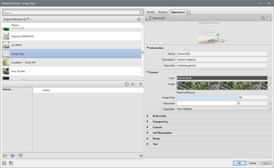

Thank you! I did everything you advised me, and I was able to choose my image as the flooring material but, the only option similar to transparency is the "Fade" option (in the "Material browser - Generic", between "Information" and "Reflectivity"). And when I change the values in this option, transparency is little or nothing applied. In AutoCad, when I use the fade option, the image is actually more transparent.

Make sure your image is sized correctly as I have shown in my previous comment.
Make sure to adjust the offset of the image as I have shown in my previous comment.
Make sure that the image repeat is set to none on both horizontal and vertical.
This will make the image visible.
