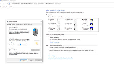

RDAOU
@oliv420v
  • Try disabling the following two options
  • Check mouse sensitivity (if mouse driver allows)
  • If the above persists look into buying a new mouse

HVAC-Novice
Check the mouse settings in windows and look if some are weird. Just write "mouse" in the Start bar.

bradH4N2Z
Select the option to disable touchpad when mouse is connected
