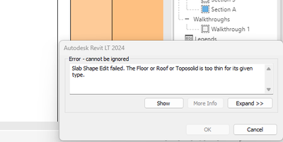

chris2FVYC
Spit tool does not work
I get the following error
Message 52 of 56
architects4
Can you show a bit more of what you are trying to do?
perhaps posting the model? (You can strip out any identifying data or move the bits that are causing an issue into a new document)
