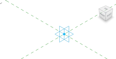

1) Reference Points
We use reference points when we need a Revit family that requires parametric precision, a family that can be modified with exact numeric distances.
Reference points have some very useful properties:
  • Rotation along the plane of its host.
  • Offset in relation to its host.
  • Location along a host element.
  • Three workplanes that can host other points, lines, or other families.
Reference points look like black dots on the screen. When they are hosted on lines, they look like smaller black dots.
