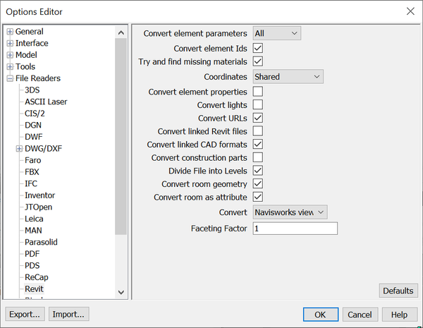

When opening my project in Navisworks, I noticed that there were extra extruded objects (see attached pics of the Revit original and the Navisworks result). They appear to be from the reference circles (i'm not sure what else to call them) that the curves were made from. I made the model in Revit, which is why I'm asking about it here.
I'm not sure what else to say here, but of course I'll provide more details as needed.
If someone could tell me if there's something I shouldn't be exporting, that would be great.

you can hide from the Revit exporting view, and make the changes from export setting to the current view. it will export only from the Revit exporting view.

I'd like to try this, but my Navisworks Options Editor doesn't have that for some reason. I'm using Navisworks 2017, but I also have 2019 and the Options Editor looks the same (see picture). What version are you using?

Why don't hou export from Revit to Navisworks instead of to IFC? The option of export visible elements in view only will be there.

Ha -- That's an excellent suggestion, and it genuinely did not occur to me to just export it straight to Navisworks! And lo and behold, it worked.

After going through the suggestion that I marked as the solution, I realized what the window is that you shared. This is the Options for exporting to NWC within Revit (for anyone else reading this thread in the future. Hi future people!), rather than the general Options Editor.
