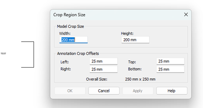

Message 13 of 13
Mike_Sanderson
It seems you can crop a drafting view. It may be a bug more than a feature, but it works.
I only just stumbled across it, so have not put it to actual use.
  1. Activate drafting view.
  2. Use the keyboard shortcut for "Show (Hide) Crop Region" Set up as "CV" for me.
  3. Deactivate the view.
  4. Now click on the view and there is a "Size Crop" button in the ribbon.
  5. The crop size is first set to the extents of whatever is in the view. The annotation crop settings don't appear to do anything.
  6. When you resize the crop boundary, it resizes from the center. There is no visible boundary, you can only find it by drawing a line that extends beyond the boundary.
  7. Detail items get cropped but text does not.
