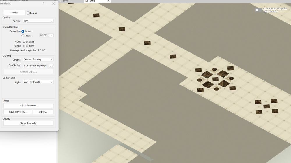

Hello! I created a floor plan with "Texture" Model Display, then mapped a custom tile pattern texture, created in other software, to the floor type. It's a high resolution image (~8000 x 4500 pixels) that looks great in Photoshop, but in the Revit plan, its fuzzy. It seems that Revit is dumbing the texture down somewhere, but I'm not sure what settings are controlling this. The sheet the drawing is on is 11x17, so its well over 300dpi for that sheet. When I look at 3D render views, the texture is also fuzzy there, so its really not a print related issue. The texture is fuzzy in the model everywhere. It it a problem that the texture scale is almost roughly 180' wide x 100' high? Images are attached.

You will need to render the view to get high resolution textures.
james_jankeKA5XA
Got it, thank you!
