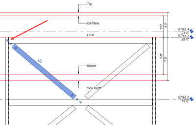

These braced frame brace symbols display as expected in plan (LEVEL 3) with the following View Range settings:
Elevation:
Plan:

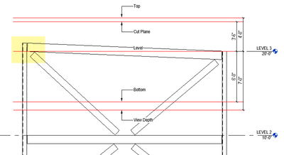

But when I raise the column above LEVEL 3 the brace symbol moves to the center of the beam:
Elevation:
Plan:
Can anyone explain the behavior here and possibly provide a solution to get the brace symbol to keep the desired location (stay at the column and point "down" like the symbol on the right)?
267 Views
joakes-DE
From what I can tell, this point right here is driving the display. Once this point goes above the "Associated Level" for a view, the brace symbol is displayed as going "up".
