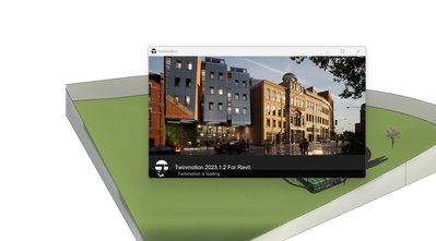

  We are experiencing the same problem. We have downloaded Revit 2024 and twinmotion 2023.1.2. When we click on the open to twinmotion icon, nothing happens. The 3D model is not displayed when twinmotion is loaded.  The same result was obtained from two different projects just to make sure that it wasn't just the one file.
thank you.
I have attached below the journal file
Message 28 of 82
ben-msa
thank you.

Thank you all for the updates. First, as a general recommendation, I would suggest installing the Revit 2024.1 update. This update includes a number of Revit + Twinmotion improvements & fixes. One of those adds a dialog which will display for cases where the Datasmith Exporter for Revit was unable to initialize but would silently fail previousy. This helps give some indication, along with the entries written to the journal, if the commands are not initialized.
The Revit 2024.1 release notes are available here.
Some specific questions\comments for recent additions to this post:
  • weinlandsammyjo | To confirm; you are in a 3D view correct? The commands shown as disabled in your screenshot are only enabled in a 3D view in Revit 2024; otherwise in non-3D views they will appear as they do in your screenshot. Please let me know!
  • ben-msa | Thank you for attaching the journal file. In your case, the journal does indicate Datasmith Exporter for Revit properly initialized:
DatasmithInitialization: Initialized successfully.
Could you confirm if the same behavior occurs after updating Revit 2024 to 2024.1? If so, could you please attach a revised journal after attempting to use Open in Twinmotion from a 3D view? Thank you.
Ryan Duell

Hello Ryan,
I downloaded the update for Revit 2024.1 and restarted the computer completely. I am coming up with the same problem at the end. I have attached the journal file below.
Thanks.
Ben
Message 32 of 82
ryan.duell
Thanks Ben.
In looking at your Revit model file name (from the journal) the issue should be the comma in the file name. If you remove that, Open in Twinmotion (or manually adding a direct link) should work as expected.
There are some current known limitations with file names and special characters that cannot be parsed and can cause a direct link connection to fail.
I confirmed once removing just the comma, saving a copy of the model, closing and re-opening it, then doing Open in Twinmotion, it worked as expected.
The first section in this page mentions this type of potential conflict - Known Issues for Twinmotion and Revit 2024 Interoperability
Please let us know if this resolves your issue, thank you!
Ryan Duell
