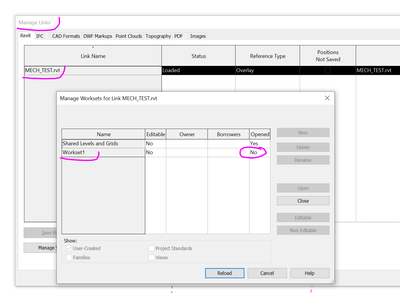

Please see the attached 2023 files to recreate the issue. All models are OOTB Revit templates.
  1. ARCH model has MECH model linked in.
  2. The MECH model does not have Workset1 linked into the ARCH modelcurtisridenour_1-1655949583199.png
  3. The CAD file is linked into the ARCH model.curtisridenour_2-1655949650278.png
  4. Open visibility graphics on any plan or RCP view and change the Import Category overrides and hit ok.curtisridenour_3-1655949766483.png
  5. An unrecoverable error occurs and Revit closes.curtisridenour_4-1655949862305.png
    The error/crash does not happen if Workset1 is linked in from the MECH model. Any help or guidance would be greatly appreciated.

Hello @curtisridenour
Thank you for reporting this and providing detailed steps.  I've been able to reproduce this and have reported to our team for investigation.  I'll reply to this post with an update.
When you crash, is there a CER report number given?
I look forward to your reply and thank you for reporting this problem.

@curtisridenour Hello , Here is a knowledgebase article to track the problem which our team is working on for a future release of Revit.  Please post back if the workaround helps.
I look forward to your reply and if this helps to solve the problem!
Crash when editing visibility graphics of imported categories in Revit | Revit 2023 | Autodesk Knowl...
For the new crash,  Were you loading worksets within the linked model and is there a CER report number?
