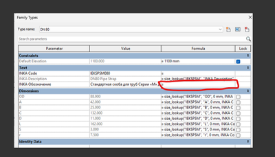

Hello everyone,
When I use the "load to project" button from within the family in Revit to load the family into the project, the description part appears correctly in the schedule. However, when I open the project and call the family into the project, the descriptions for different types appear the same. I would greatly appreciate any assistance with this issue.

Berat_Dogan53CT8
I have no issues with loading the family.

azad.Nanva
is this correct ?
I think this have a problem.
Message 7 of 10
Berat_Dogan53CT8
Yes, that's correct. If I call it from the table, the Russian characters get corrupted because it is in .csv format.

azad.Nanva
no i don't think so, your key is InkaCode not InkaO6...
show me the formula ,
if you change the type in type name or change the "INKA Code" all the variable change except the "INKA 06..." so i think this is the problem.

admaecc211151
Would that be help if you change the format of CSV from UTF-8 to ANSI?
Since I'm using Chinese version more, I need to check the txt file formats often.
