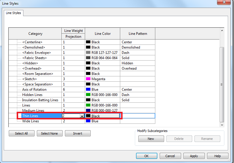

Hii,
 I have a problem when printing to PDF in revit 2018.2. Please see the attached pics. The bars and other lines are bulgy. it is always printing with the  line weight even if I select the  ''Thin line'' option.  its is not what I see in revit. I tried with cute pdf, Pdf creator, DoPDF, Bio pdf etc. and even checked with DWF exporter. Still the result is same. I don't have any problem with pdf printing when I was using revit 2017.

The "Thin line" type itself may having a line weight , and so try to go to ,
Manage > Additional Settings > Line style
and choose your line style " Thin Line " and change its line weight and let it be "1" (as attached JPG`s)
the reason at your case that let lines having different graphical appearance between Revit & PDF , I think because you are using (TL) tool , disable this tool to be able to see the same line weights in Revit and in PDF (see attached JPG)

shefypattambi
I here is the sample of pictures after installing the bull pdf. problem still there. please check the tag of each picture.
BULL PDF THIN LINE OFF.PNGBULL PDF THIN LINE ON.PNGRevit thin line off.PNGRevit Thin Line on.PNGLine Style.PNG

shefypattambi
I believe revit is giving what you see that what you get. In this case it is not.
