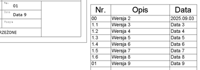

Is there a way to improve the revision schedule? What I’d like to achieve is a general, countable revision system with sub-revisions that are not counted by sheet parameters. I’ve been using a Revision Clouds Schedule, but maybe there’s a better solution.
Something like that:
Nr Description Date
1Lorem ipsum dolor2025.09.04
1.1Sit amet consectetur2025.09.04
1.2Adipiscing elit2025.09.04
1.3Sed do eiusmod2025.09.04
1.4Tempor incididunt ut2025.09.04
1.5Labore et dolore2025.09.04
2Magna aliqua2025.09.11
2.1Ut enim ad minim2025.09.11
2.2Veniam quis nostrud2025.09.11
2.3Exercitation ullamco2025.09.11
Thanks for your help!

You could accomplish this with a series of Numbering types.
Revisions is setup like this.
Sub-Revision 1 is setup with a prefix "1."
Any time you want the prefix to change you would need to create a new sub-revision with the new prefix.
s_dziedzicBJXBG
It works! I thought I was aware of this option, but the issue was with the Current Revision label on the sheet. It turns out that this parameter follows the numbering style of the last revision, so in the end it looks good enough!
