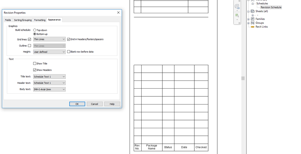

I want to make a Title Block following my client title block DWG file. In the AutoCad file the revision Schedule box have an Exact height with 10 row. In Revit I found out that I am not able to resize the revision schedule row height. the icon is gray and the size only changes when I increase the size of body text. The fact is that I want the body text to be 2 mm, and with this setting my schedule including the 10 rows does not have the height that I want. Is there any way that I can increase the height of rows without increasing the text height?

I don't think it can be done to Revision schedules.

Thank you for taking your time to post this on the forum,
I can see why you would have the need to adjust this, but currently it isn't a feature you have available in Revit.
To get it implemented I would recommend you vote for it on the IDEA page - I've already found a matching post.

Could you add a cell to the schedule and leave it very narrow, the add text in the color white into that cell - make the text tall enough to set the height of the table.  Since its white, it wont print.  Might even make a custom text style for it with a 0.001 width factor if necessary.

Pretty sure you can't do any of those to a Revision Schedule.
@Anonymous
See the attached 2019 file for a workaround.  Let me know if you can make any sense out of it.

How was this done? I can't figure out what you did to have differing heights of text and rows.
Message 8 of 12
I added a bunch of spaces in the Revision description and end them with an Unicode character.

Nice. I tried it and it definitely works. If it was just me I'd use it, but there's no way I'm trusting the people around here with that workaround. Makes no sense that we can't change the size of the body text rows without changing the size of the text. Or at least make the revision schedule parameters accessible so we can create our own labels/schedules. Ah well.
