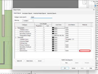

There's no material added on object styles to Toposolid, so there's nothing to adjust there. The only things that can be adjusted, if I recall correctly, are the things I posted.

If the “Material” field is set to “By Category,” the background should match the general Toposolid layout that you have already created. However, since there may be many different elements in a subcategory, it’s better to set the material and its graphics individually for each one

In the object styles for the “subdivision” subcategory, you can also assign a material with the desired background display (similar to the main Toposolid), but this will apply to all such subdivisions—if that works for you, of course.
If not, it’s better to simply configure a view template specifically for a rough display and override the graphics for any element in the filters

It worked! Thank you so much!
