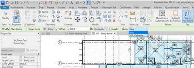

Most would recommend deleting and recreating and you can use the Option Bar > Room Drop down and reselect the room Name from the list of deleted rooms.

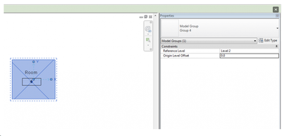

Grouping
  1. Group the Room element
  2. Change the Level field of the Group
  3. Ungroup
Unfortunately, while this doesn’t result in multiple entries in a Room Schedule (like Cut / Paste will), it does result in a new Element ID for the Room element.
