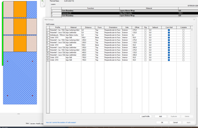

I use a wall family to represent foundation constructions, where I've incorporated various sweeps into the type to illustrate the layers of the foundation (see Image 1).

It is crucial for me to point out i use sweeps embedded in the family type (see Image 6).
Has anyone encountered similar challenges or has experience preserving sweeps during terrain cut and geometry join? I would appreciate any help or insights you can share.
