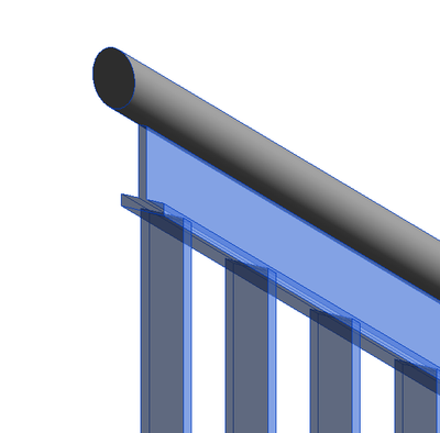

is there a possibility to control the way the railing joins with the terminations? As you can see on the picture below, it doesn't connect automatically and I cannot find any setting that controls it. (The railing is sloped since it is hosted to stairs.)
Secondly, I'd like to shorten the lower part of the railing (T profile) a bit but the "Length" parameter is greyed out - maybe there's some way to unlock it?
The upper part of the whole railing consists of: the "handrail" with "terminations" (round profile) and the "top rail" (T profile)
Thanks in advance!

For the termination and the way it connects to the rail, you need to edit the termination family and model the transition/connection therein...you can find them in the project browser >> families >> under category Railing
For the length ...Edit the sketch of the rail first to shorten a notch finish sketch then  tab select the top Rail >> edit the Profile >>> extend it slightly

You cannot shorten a top rail without an extension.  In other words, the top rail (and handrail) sketch cannot be shorter then the railing sketch.
If the railing is not on a slope, you can draw the railing sketch the same length as the T length, offset the start and end post outward, and add extensions to the round handrail to compensate the length difference.
For simplicity, you can create the T as a separate railing type, and sketch it shorter in the same place as the main railing.  That would work for both flat and slope conditions.

Extended without the termination by editing path as mentioned above ... Alternatively you reset the path and extend using a custom termination family

It is not an option ... you have to use a family template or edit an existing one and model it therein...ie: you create a custom termination family using extrusions, sweeps, blends...etc that follows the slope/angle of the rail from one end and extends further in which ever direction you wish or shape you desire
If it is a simple thing similar to the image I posted above, then you do not need a termination...you can achieve that by editing the Top Rail path

Ok, I created the termination just as you described it.
I can see that it connects well with the horizontally aligned handrail but doesn't work with the sloped one.

You need to edit the Top Rail Path and give it a nudge forward (you can reduce the Termination thickness to deduct the added height

Wow, I didn't know about this trick. Thank you very much!
