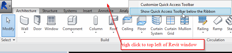

Message 14 of 51
It's very easy. you just need to right click to top left of revit window and the text will display for your option, that's it.2016-01-17 11_53_16-AdApplicationButton.png
