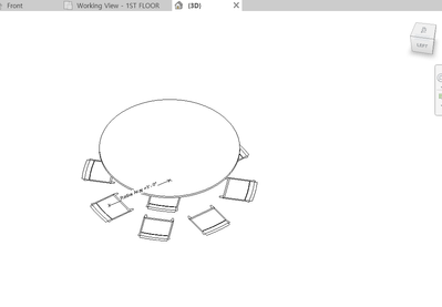

I am working on a furniture family a round table with chairs. I used extrusion for the table without any legs for simplicity, and chairs as a detail lines. The table is float 1' 10" off the ground level but I still see the chairs line beneath the table.
 I want to hide the chair lines under the table. Anyone knows how to fix that??

Change your visual style to hidden line instead of wireframe. Either this, or make the half of the chair that's under the table not visible in plan view using visibility/graphics overrides, but not sure why you would do that. Typically it would be displayed as a hidden line/dashed line if it underneath something.

Convert the chair lines to Model lines and place them at the ref level. And if you want the lines to be visible only in Plan View, change the Visibility Settings to Plan only.
