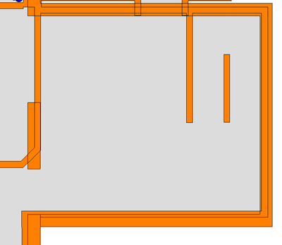

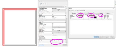

I'm having trouble getting phases in a linked model to show the way that I would expect them to.
View phase settings are:
Phase filter settings are the default:
Phase graphic overrides are:
 Phase mapping is:
But view displays as:
I can't figure out why, with the Show Complete filter, the existing walls show as overridden to halftone when they should be "By Category".

To make sure that I wasn't going crazy I made a test link and test host and the phase filters work absolutely fine without having to use linked views (as I've been doing for several years now):-
I've come to the conclusion that there's something (not sure what) wierd about the phasing in the linked model.
One thing that confused me @RDAOU was why I had mapped the phases the way that they were (did that a while back and couldn't remember) but it turns out that the Architect has now removed/merged their Final phase into their New Constructon phase and Revit must have automatically changed my phase mapping to suit - I've now merged my Final phase into New Construction so that I have direct compatibility but it hasn't solved the problem.

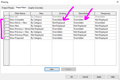

It turns out that the Architect has changed the phase filter settings in their model and caused the Show Complete filter to not show complete - it basically works the same as the Show All filter except that Temporary isn't seen and its the same as another Filter which they've called Show Proposed:
I changed the settings in their model and now phasing works fine in my own model without having to use linked views (which weren't working anyway because they were also using the "broken" phase filter in the link).

Played about with this a bit more and it seems that both the host and the link files must contain a Phase Filter of the same name and settings.
I'd never had the problem before because my project and the linked files were always using the default out of the box settings.
So if custom phase filter settings are needed in a project then I would suggest that the default filters should be left per their OOTB settings and new additional filters should be created rather than amending the default filters.
