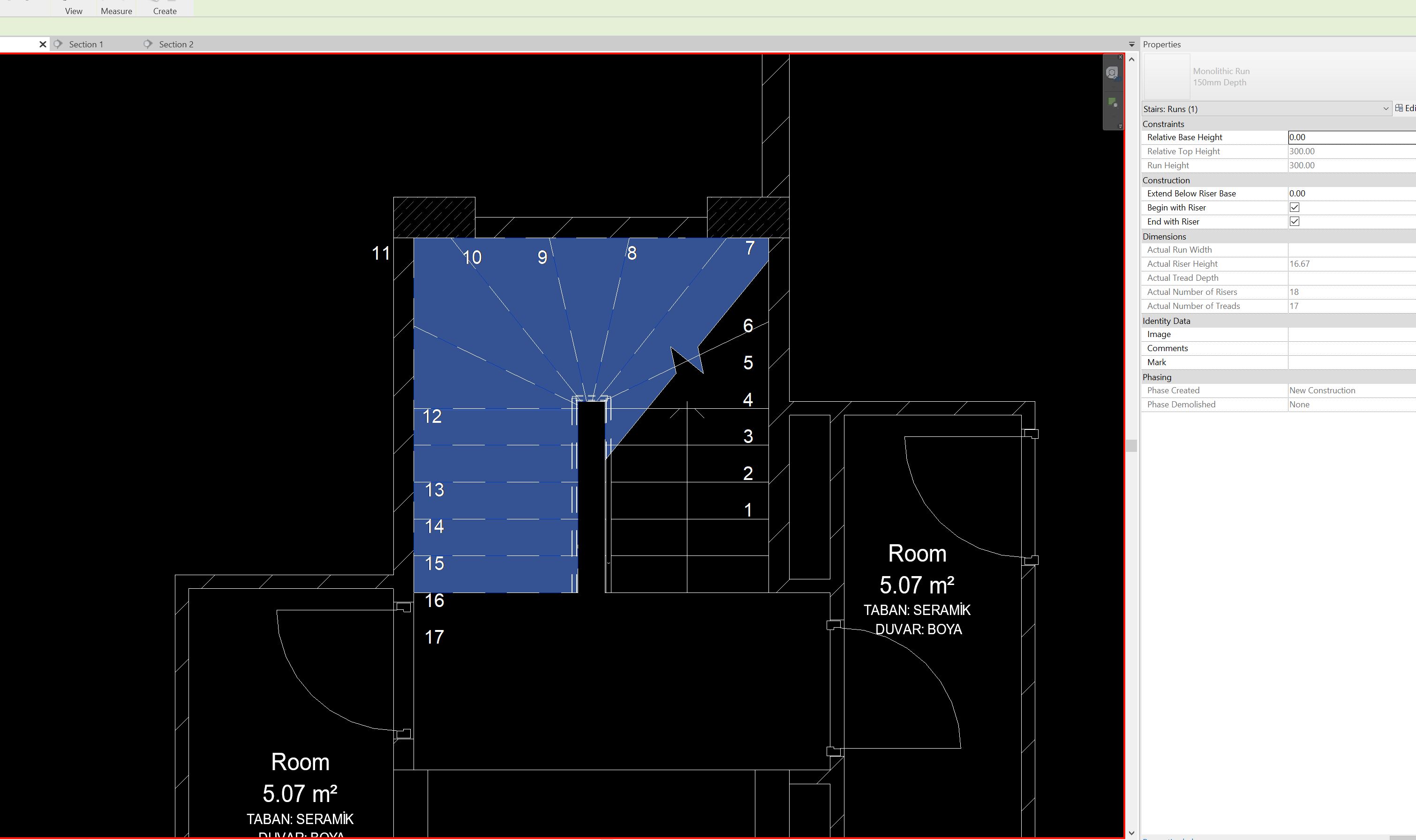

When i was stair numbering, dont start firt number in first tread.
how i fix that?

@e_inan58
Try Either of the following
  • Option 1: Use the Tab key to select the RUN then check the box "Begin with Riser"
  • Option 2: If stair run should not start with riser...Select the numbering annotation and change it to Treads instead of risers

when i do the first option it still doesn't fix
Note: I created the stair with a sketch

Can you attach the Revit file? maybe someone can have a look at instead of guessing
PS: you can copy the stairs and paste in a new file if you cannot share all the model

The stairs...it is the risers distribution which is causing that. What you can do is
  1. Start the stair and use from the tools the U Shaped Winder
  2. Set the necessary values (15 steps, and depth of the tread)
  3. Place it and Finish
  4. Then Convert to Sketch and adjust the Borders to meet the dimensions you need
