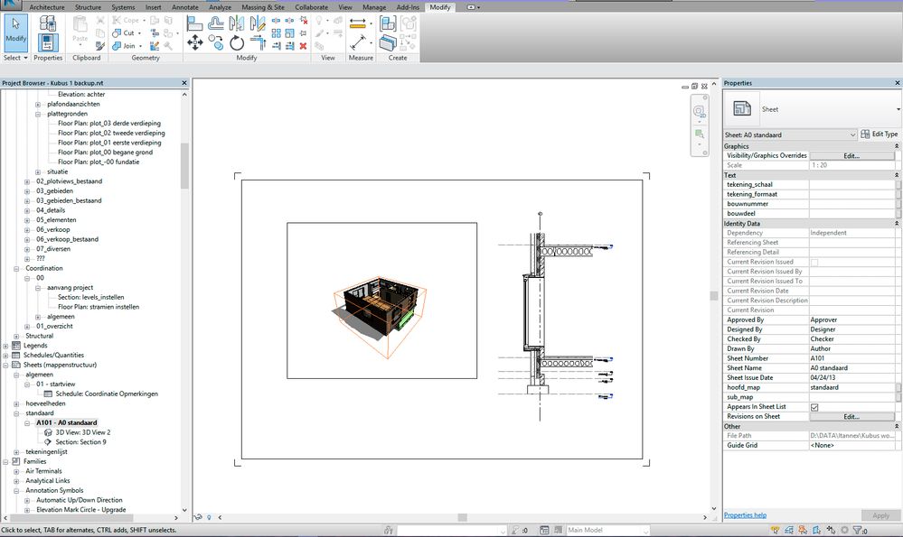

Hello
I have a simple question, who knows?
How can I enlarge this perspective view on this sheet? (see jpg)
thanks for the answer

Hi @LPRevit,
Perspectives can be enlarged via the contectual ribbon > crop size. Once the view is selected on the sheet
Don't forget to tick the scaling box otherwise you will only enlarge the crop rectangle!

"Size Crop"???

Thank you François !!!!

Sorry, I often switch from english to french version of the software and am on the french version at the moment...
Sometimes i get the labels slightly wrong...!
Size crop it is!

"Taille du cadre" in French...

You already have the best answer.
But an alternative is to, you know, just move the camera closer to the building.
