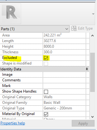

Do you have accidentally check the excluded ?
Message 8 of 11
Nope, the box is unchecked. Well, I don't see the wall, so it's not possible to check if it's checked or not. But the wall does not behave as it would if it was excluded. It's just gone.
