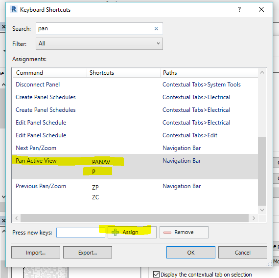

Okay, I am reading a book how to use Revit, lots of features are COOL. I am sure I will use Revit so on.
But there are two tiny things- I HATE it!  Okay, that is Panning and Orbiting. My understanding is that I have to hold down the mouse wheel to pan or orbit, I don't like it because I may have Carpal Tunnel Syndrome. That is not good for my wrists.
So, on AutoCAD Architecture 2017, I use AutoLISP short-cut command for Pan and Orbit. It works great because it balanced between using left wrist and right wrist. But to hold down the mouse wheel, I am concerned it may cause CTS.
Any idea of having keyboard shortcuts for Pan and Orbit?

Viveka_CD
Hi @WFTDesign
Revit uses the F8 key to Dynamically Modify View (3D Orbit)
We do have an option to assign a keyboard shortcut for the PAN but looks like you have to still hold down the mouse button. See image below -
If you are looking for an alternative then I suggest taking a look at the Spacemouse by 3DConnection HERE

I am reaching out to the API team on the short key configuration for Revit and will keep you posted for an update.
