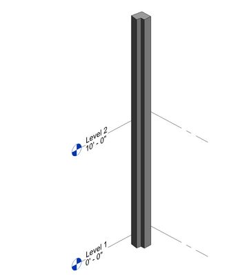

Hello everyone
How ca I create  a custom, nonrectangular, structural, concrete column section in Revit?

dm0144
Did it with model in place component.
Idk if it is a good practice.
Message 4 of 8
dm0144
The component is not recognized as a structural element and I couldn't use it for structural analysis.
Is it possible to convert it (the model in place component) into a column element so it behaves like a column?

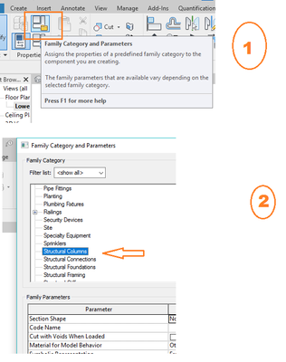

selmanyesil
Hello
give it a column category  to your in place model
