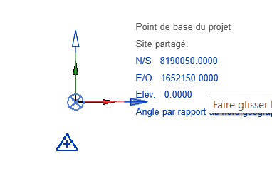

having trouble resetting shared coordiates.  I have two rvt. files, in pic 1, as you can see, the internal origin isn't aligned with project point, so I tried to reset it and reset shared coordiates too.  In pic 3 and 4, all is at 0,0,0, so it means my two files are supposed to share the same coordiantes system if I use survey point to survey point to link.
Revit gave me a warnning that the two file don't share the same coordinates and it will use centre to center, yet I reset the coordiates for both file, they are both at 0,0,0 ( I've also tried resetting both files and giving them 5,5,0 as survey point ).
So what exactly does Reset shared coordinates do?  For my understanding, if I reset two different projects, and reassign the coordinates, these two files should match...... Thanks.

Well, it works correctly here.  Reset Shared Coordinates does eliminate Shared Coordinates (the link Shared Site is shown as <Not Shared>), and the host Survey Point is relocate to where it originally was.

Yah, I can see what is does.  It moves the SP back to the IO and eliminates Shared Coordinates (e.g. removes linked coordinate relationships with the host).  The reason Revit is throwing this message:
is because you are Linking via "Shared Coordinates" after eliminating Shared Coordinates via Reset Shared Coordinates.  There is no "Shared Coordinates". So, let the Link land center-to-center in the Host and then reposition it manually -- and record and save the new position back to the Link Project.
Note: if you simply move the Host's Survey Point (in clipped state) to the Project Base Point/Internal Origin - and not Reset Shared Coordinates - the coordinate relationships between the Shared Links and the Host's Survey Point will be maintained.  In other words, the Links will move along with the Survey Point.
...FWIW, let me add this: in your first post, it looks like you are showing screen captures of your Project Base Point Coordinates. PBP Coordinates have nothing to do with Shared Coordinates.  Shared Coordinates are established between Link-Host Survey Point Origins.

I think you meant Link by Shared Coordinates.  Revit gave you the message because there is no longer a shared coordinates system in your link file.  You have already reset/eliminate it.  I can give you that the wording of the message is rather misleading.
