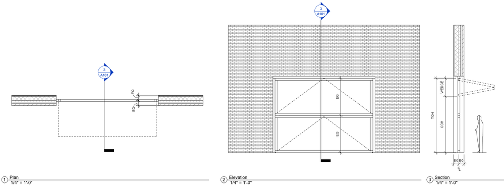

A Hangar Door? Why don't you keep it simple? Create the door geometry with Curtain Wall Mullions and Panels and embed the Curtain Wall into the Host Wall.  Use Detail Lines to create Swing Lines in the Views you need to show them.
...if you want the Curtain Wall Panel centered in the Host Wall, then zero out the Offset.
...one more for you:
