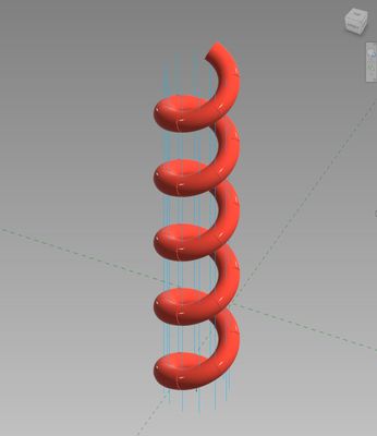

Hi all,
I have always faced this problem of having bad broken lines on curved edges(as photo)
It often occurs when I import organic model from 3DsMax, but now it seems to happen even when I am building in Revit , using sweep in Generic Model.
I understand it may be a graphic issue, but it becomes rather annoying because I often needed these elements to appear in drawings. I wonder if there is a fix for the missing lines or is there a better work around for curved elements as such?
Any suggestion is much appreciated, thanks!

Regarding what is happening in your family; I've seen this happen to Structural Beams. The fix was to change the  Cross-Section Rotation value.   I suspect it's related.  Something to do with the twisting of your sweeps.

You can try semi-circle profile instead of full circle if you want to make the line show up.

Thanks for the suggestion on other ways to create the helix. As it is a rather minor part of the model, I was trying to keep the model simple to perhaps keep the file lighter.
You were mentioning " Something to do with the twisting of your sweeps." I don't really get that, what would you suggest to be changed in my sweep?
One thing I noticed is that the edges are visible when being zoomed in, I wonder if you have any past encounter or thoughts on this?

It depends how you built the model. When you use external software and insert into Revit, Revit may not translate those curve as line. If I built it natively within Revit using spline, Revit pickup those lines no issue.
It isn't 100% full proof because even object built with Revit tool may not show those curve.
