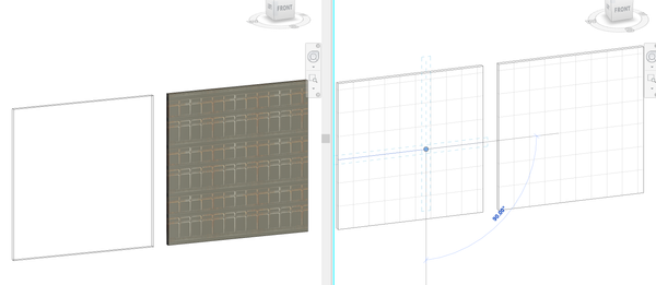

Can someone help me to solve this issue regarding the material texture it rotate to vertical in the other side it should be horizontal only. I used sweep in modeling this facade. Thanks!

Add the model hatch to the material. Then you can rotate the model hatch pattern and it will rotate your material.
If the above method will not work, then you have to duplicate your material and the asset. Then rotate the image material to 90 degree. Afterward you apply paint surface and pick your 90 degree rotated material.
