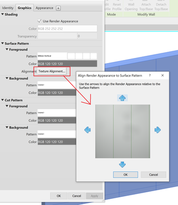

syman2000
All you need is just to know the width and length of the tile.
How you create the model hatch pattern is first go to your wall elevation and turn the wall to realistic. Draw drafting line to see your pattern size
Once you know the size, then you can create your model pattern
In the hatch pattern you basically create the crosshatch and enter in the value
For the texture alignment, make sure it align with the texture map.
Once you have the texture map and model hatch match, you can start moving the model line and the texture map will align with it. See the video
