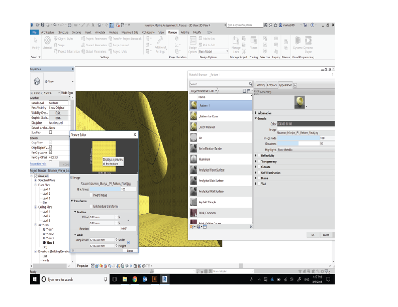

Artboard 1.pngHello,
Would anyone know how I can uniformly put a jpeg image of a pattern  that I designed on the cone of this interior. I tried my best to play with the setting but these lines show.

Hi Viveka,
I actually modeled the interior in Revit Mass then brought it into Revit Project. I designed a pattern which I then applied to all the walls. For some reason when I apply the pattern to the Cone and the Roof it shows up weird. I dont have a bump in the pattern
Here are the settings

Viveka_CD
Hi @Anonymous
The settings are all ok.
A few things to check:
1. Are you sure the pattern you created does not have a black outline or border?
2. Try to make a duplicate and crop the pattern and reassign.
3. Can you select the lines and override the graphics - make them not visible?
4.See  article on Aligning the Render Appearance to the Surface Pattern
If none of the above work, can you share the pattern and part of the model so I can test further. I can share a private folder if you'd prefer.
