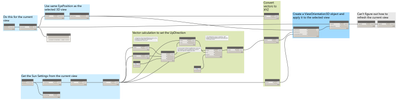

lucdoucet_msdl
@alexlj and @Anonymous,
This seems a job for Dynamo which has nodes for obtaining the sun settings of a 3D view then manipulating the orientation of the view to match. You could try posting your problem to the Dynamo forums.
In this scenario, you would set the 3D view sun settings by date and time and then run the dynamo script would read these and set the view orientation accordingly.
Good luck,
-luc
P.S. Here are some of the nodes from the Synthetic package in question and where I fail to move forward:
What is missing is a method to convert the sun vector to a ViewOrientation3D object. It is discussed in the following blog post.
https://thebuildingcoder.typepad.com/blog/2013/04/setting-up-your-vieworientation3d.html

Message 12 of 23
lucdoucet_msdl
@alexlj
Got it to work in Dynamo. Here's the script and a screen cast for using it.
  1. Open a 3D orthographic view;
  2. Set the time and date for the view;
  3. Run the Dynamo script.
-luc

Message 20 of 23
lucdoucet_msdl
@Anonymous
You are correct, I realize that the dynamo script is aligning the view with respect to the project orientation and not the true north. My mistake was testing it when the true north and project norths were aligned.
To adjust for this, the script must read the angle deviation from north parameter in the project base point, then rotate the vector "ForwardDirection" in the "ViewOrientation3d.ByEyeUpForwardDirections" node about the "Z" axis by that amount before calculating the "UpDirection" (See arrow below)
The node for the deviation between true and project north is called "Coordinates.ProjectRotation".
Here's a revised version for you to test.
