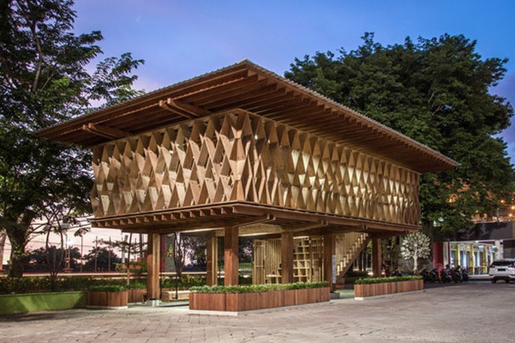

You cannot do that using the family you were working with...the angle in your image applies to the Grids (Virtical and Horizontal) not to the panel...you have 2 options
Option 1: Use a Mass surface ... divided to a pattern, rotate Grid >>> apply a Pattern based family to that
Option 2: Use a mass surface ... divide to a pattern, rotate grid >>> activate nodes >>> use an adaptive component
Option 3: Use the second method which I posted in my 2nd Reply using a curtain wall with Vertical + Horizontal mullions and an empty System Panel As below

If you want to get your panel to have angle mullion, you may have to use adaptive. See attached how to do it.

Just wanted to let you know that a loadable curtain panel family will not work if your curtain wall is not a rectangle.
An approach to this is using mullions for louver blades + empty system panel. This would work with any shapes.

i got it thx  a lot
