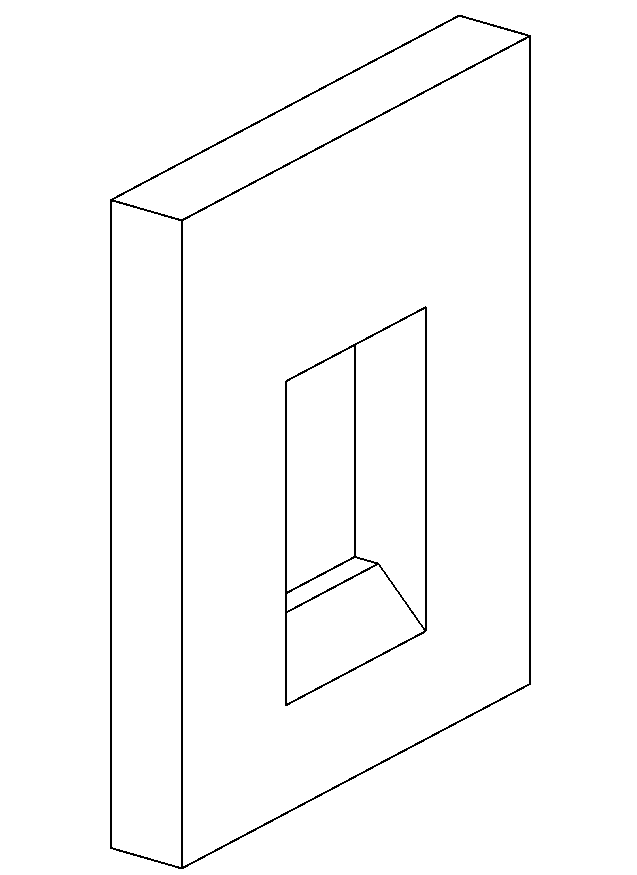

The company I work for does some custom homes with small clerestory or other windows set high in a thick wall. With a 45 degree stucco sill on the outside. Kinda makes the home look massive like an adobe or straw bale wall. Anyone know where I can find such an item.
Here's a sketch of the condition: http://prntscr.com/jzqlsc
I am just learning the program and this detail is key. Have tried a couple ways of modeling it without success, thanks.

A window "opening" will cut through any depth host.
To create a slope sill, you'll need to use a Void Cut, in lieu of an Opening, but it too can be constrained to the exterior and interior faces of the host wall.
Message 3 of 13
Use a void to create the opening.  See screencast for a demonstration in a few minutes.

Hello
Check out  the window family uploaded in the dropbox..
you will get results shown... Edit it the way you want further..
https://www.dropbox.com/sh/xh2p48vrjt6akx3/AABtMPxRkc2Ando0RALGg66na?dl=0
Cheers !
Corsten
Building Designer
Message 5 of 13
Thanks so much! Very helpful.
Whenever I see the image of a four-armed elephant I will think of you Ganesh!
Metric is not a problem either, the window works out to be very close to 24" by 24" "Old English" size.

Corsten.Au
Hello
heres the link for Revit file.
https://corstenau-my.sharepoint.com/:f:/g/personal/ganesh_corsten_com_au/EisApF34x1dDiuX4egFsFKABKYX...
Opening cut, extend with parameterOpening cut, extend with parameterfill wall part which is getting cut due to openingfill wall part which is getting cut due to openingfinal result.final result.
Corsten
