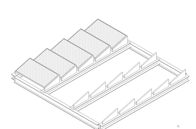

I need to lock the edges of the panels to the lower support edges like the most front panel, so they can move along with them . Due to the visibility issue, I do the alignment  in 3D view, however, the lock doesn't show up. Is there a way to do this?

Align the bottom surface of the panels with the top surface of the pony wall. Do it for one panel then copy / array the rest.
Message 9 of 23
hliS658H
Yes, no problem to align BUT they need to be locked, so when I change the height, they would follow up and not like what you see now in the screenshot.
Message 10 of 23
hliS658H
I can only lock the highlighted panel in front view, the other panels will be hid and now way to do the align and lock to the edge ( not a face), when you copy/array, the lock relationship will be lost. I am trying to edit an existing family with issues, I might be able to copy/array the panel and support without losing the locks if I remodel the support. You see 20 supports, but they are only 4 objects
Message 11 of 23
Problem #1 is that your Work Plane Based Panels are not associated to any Work Planes.  That's the first thing you need to correct.

For the first row, I was able to lock the panels (I did it in front view), but for the second and more rows behind the first row, I had problem, because the edges of the supports are invisible. I am thinking, perhaps the section box suggested by the first response would be helpful. I am just not sure how to use section box in family editing environment.

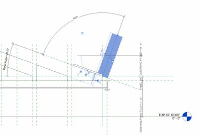

Also, one more screenshot for you:

See attached.  Each panel is hosted on the face of a sloped curb.  Open the Left Elevation for more constraint information.  Your panel family needs not to be changed.

Yes, I studied your model and tried to understand it. It performs better than mine with some different settings. Here are my questions:
1. Why is  Solar Array Frame T.O.S needed to be locked ?  Why can we still change the number when it is locked?
2.  Why is reference line used here rather than reference plane?
