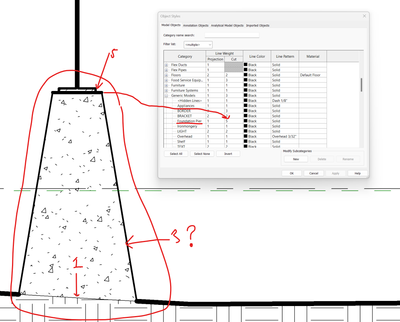

I followed the instructions in this thread and made a subcategory "Foundation Pier". I change its cut line and it only changes the top line. How do I change all the cut lines in this model in place generic model in section?

als Antwort auf: cscott12ZX5LX
Edit the model in place, select the 3d element and assign it to the subcategory. If it is 2d lines or 2d regions, select the lines or the regions sketch lines and assign them to the subcategory cut or projection lines.
The work is no different than for loadable families.

All of sudden changing the object styles cut line works after opening the model today (which you can see in my previous image didn't work). Revit 2025 appears to have many glitches.

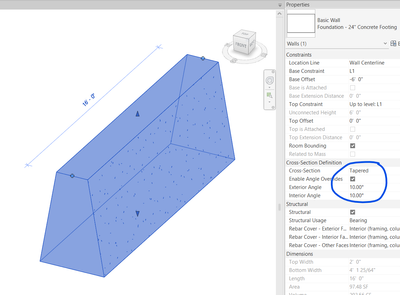

Why don't you use tapered wall?
