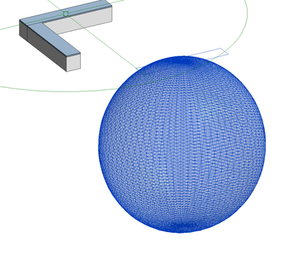

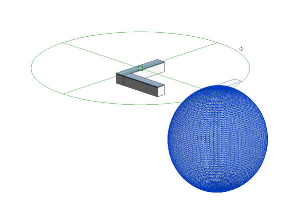

I have a strange problem.
Using rectangular light source with IES file creates shadows in rendering even tough the light source should not have any effect on the rendering. How to avoid light source influencing a rendering?
I have tried turning light source off in VG but no difference
I am running Revit 2018.
In the family shown I have moved the light source in the lighting fixture away form the fixture itself to illustrate the problem.
Photometric setting shown at the last picture.

Almost sounds like you are describing an effect produced by a material that has a Self-Illumination Property (untickable).   Post the file.
Message 3 of 21
Yep, that's what it was. The material assigned to the geometry of the light has "Self-Illumination" checked (under Appearance tab).  Uncheck it.
Message 4 of 21
FWIW: Your Light Family is peculiar to me. The Light Source in it is not positioned directly under the housing. Is this intentional?

Hi Barthbradley
Thanks for your reply and ideas for a solution.
Turning self illumination off has no effect.
Turning light source off in visibility graphics for the view has no effect. (if I turn off Lighting Fixture in VG lighting fixture are not rendered - off cause!)
It was by intention that I moved the light source away from the lighting fixture to clearly illustrate the problem.
I have testet different settings and found that it is the IES file used for this lighting fixture that causes the problem. And importantly to note it affects other lighting as well - meaning that all light sources from different lighting fixtures cast shadows even thoug they work just fine if used alone. When changing the IES file all light sources act as expected.
IES seems to be a bit tricky to use. Even slightly inaccuracy seems to have great impact.
Once again thanks for your time on this issue.

If you are taking what is shown in this screenshot; this is correct behavior. In fact, it's well-documented. IES Light Shape does not display in Realistic Mode. Only the Emit Shape displays in Realistic Mode with "Light Source" Subcategory turned on.
Again; the reason the Emit Shape is not positioned at the light fixture housing geometry is because you offset the Light Source in the Family - as I explained and pictured above.

Hi again
You are right. After posting that it seemed like the IES giving problems I testet furter and found that it was a combination of a different IES and moving the light source downward that seemed to have a positive effect.
Just to clearify the issue - when rendering I get theses "shadows" at the ceiling which comes from the light source inside the Light fixture family. Attached is the IES files I use.
I have testet in Revit 2020 with same result.
I render in HIGH quality - Dont you get these shadows if you open the file rotat to look upward at the ceiling an render in high? what Revit version are you running?

I came to the conclusion that the "shadow" is part of the IES information. Simply reflects the shadow which the lighting fixture will cast.
This leads to the problem that objects in the family cast shadows itself. If possible the objects in the family should be excluded from casting shadows from the IES light source inside the family. This seems not possible in Revit 2018.
