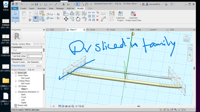

hello,
I made a joined geometry which slice well in family, but after nest in project, it is not slice anymore,
I had tried "share/not shared", "cut when loaded" etc but also not sliced in project,
Please advice, thanks
