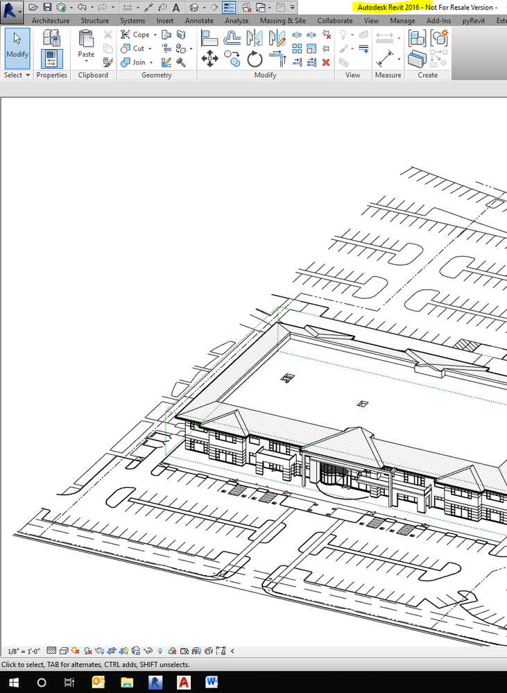

I installed it for one of my users (and reinstalled it) and he can't zoom on images and there are flickering boxes in the lower right corner.
Someone else had this problem and "solved" it by going back to Win 7.  I'd rather not do that if possible.
Is there a way to make Revit 2016 work in Win 10?

Message 24 of 30
I'd like to know if someone had trouble getting it to work, but fixed it.  And of course, what that fix was.
Any theories on what to try?
Message 25 of 30
I haven't had any issues since the initial installation so there are no fixes needed for me. What problems are you getting?
Message 26 of 30
Once a file loads, we can't zoom or pan. There's a flickering in the bottom right corner, in the fields that show measurements of some kind.
It's been a while since I looked at the user's computer to see the problems.
Message 27 of 30
Viveka_CD
@Anonymous  this is likely that this flickering is a graphics issue. Have you tried toggling hardware acceleration and checking the graphics card compatibility + checking for latest driver updates from the manufacturer's website?

Message 28 of 30
Not yet, but I will.  Thank you.

Message 30 of 30
I haven't try. But from computer tech point of view, you should try either change different hardware (maybe video card),
or change hw drivers
