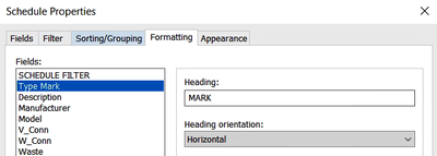

you can also go into the Formatting Tab and change the name of the header there.  The parameter name stays the same, it just overwrites the header name in the schedule, unless I'm missing something.

I think the title of the thread is wrong. The question is about how to overwrite text in values, in cells, such as changing the name of a level to be something else. But the question is entitled "is it possible to override text in schedule headers", for which the answer would be what you just said, using the Formatting tab of the schedule's settings. Or writing on the headers in the schedule view.
