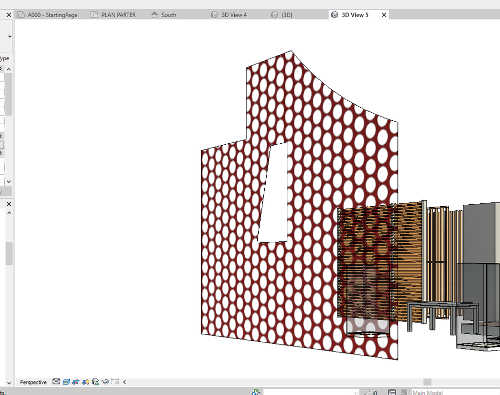

Hi All. I have found lots of different tutorials on how to create a parametric panel family of a perforated metal sheet similar to the link below. But I cant seem to find one that works with irregular shapes? The only ones I could find only seem to work with either as square or rectangular shapes rather than a shape like these?  I was hoping someone could point me to ward a tutorial on how to create a panel family that would work with shapes like those?

is this what you want?

if that is what you want , it can be achieved by using a Mass face with UV Grids infilled with a Curtain Panel Pattern Based Family, like in this screenshot:

anyway I'd better use a Mass Face with a Procedural Map for Realistic View and Rendering, not a true 3d model..
How it will look by using this method:
