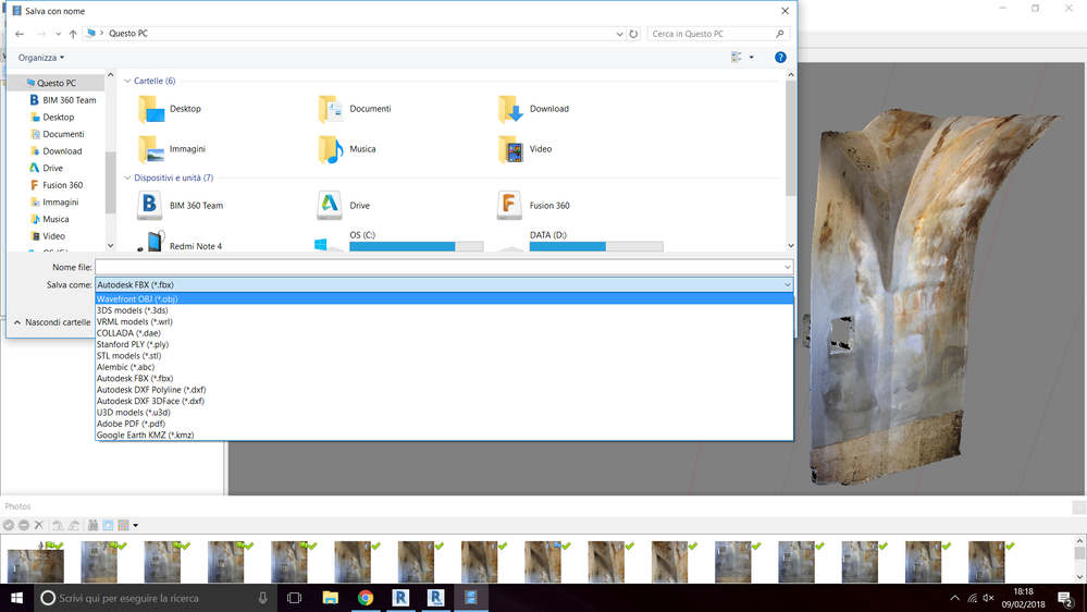

Hi everyone,
I've carried out a Image-based metric survey and I manage it with Agisoft Photoscan.
Firstly, I've obtained a  very dense point cloud ( > 1 500 000 000 points)  and I've already imported it on Revit with success, so far so good.
In Photoscan I've obtained a 3d texturized model (the textures are not materials but a high quality photo collage) as shown in the attached picture (it's just a piece of the whole survey) .
My question is: there is a way to import this 3d texturized model in Revit?
Photoscan permits to export model in :
• Wavefront OBJ • 3DS file format • VRML • COLLADA • Stanford PLY • Autodesk DXF • U3D • Adobe PDF
Thanks you in advance for the help in the resolution of this matter.
Best regards,
Andrea

I've tried right now. Photoscan produces a dxf file of 377 mb and when I tent to link it, Revit not responding.

I suspect it's not the texturing at all; the DXF file is likely only the mesh.  You can attempt to walk it through other formats first, such as 3DS, but you're going to get the same results.
Revit, as a design tool, is set up to work with ideal solids.  When converted the scans into a mesh, you got *all* the details - warps, bumps, twists, and all.  Even without the textures Revit is likely going to choke on something that big especially all in one go.  And if you need a monster computer to work with it (what you stated isn't even close), chances are whoever gets the model after you won't be able to do anything with it.
If you are hoping to use that mesh as a substitute to creating Revit objects you're probably not going to get that.  Ideally, you would chop the mesh up into small, logically workable design areas.  Bring those into Revit individually, one at a time, and use Revit to create objects that are best-fit.  Then remove the mesh, and move on to the next one.
