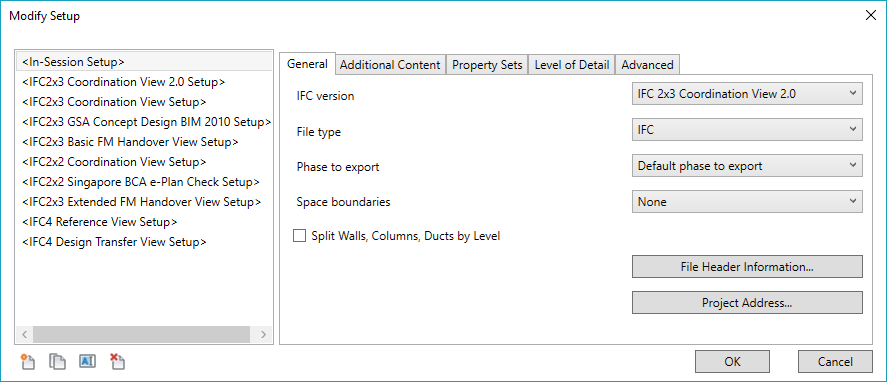

I export IFC from Revit, but IFC file lost Families parameters...
I need to set a Level parameter For Curtain Panels, but when I open my  IFC export in Navisworks or ASTA power project I  do not have any of parameters at IFC properties column.
Any idea why I can not have or export Curtain Panel parameters?
Thanks for any idea/ solution.

Viveka_CD
Hi @Anonymous
The main Export window is very basic and offers all currently open project in a list – in general it makes sense to export only one project at once, as many settings are project specific.Click on Export - IFC - Modify Setup
Modify Setup opens a dialog with more detailed settings and offers a choice between all implemented MVDs. These MVDs can be adapted if needed and also save as new definition.These are settings available in the Modify Setup dialog:
IFC Version: offers all implemented versions along with the MVDs – the most commonly used is the IFC2x3 Coordination View 2.0, while IFC4 offers better results for complex geometry, however it is not supported by all software yet.
If the exported IFC is to be used for coordination purposes (e.g. is not going to be edited but only referenced or used in an IFC Viewer), it is recommended to use IFC 2x3 Coordination View 2.0 or IFC4 Reference View.
If the IFC is intended for editing in another editing software, it is recommended to use IFC4 Model Transfer View.
If you have any more questions, please let us know.

It looks that I have right now IFC Setup but it looks that I do not have some of the options ( Level of Detail, Additional Content ). I am using REVIT 2016 version. Perhaps ... it is because of my old version?
But still I need to set Curtain Panels parameters defined by myself and after IFC export at IFC file I do not have those parameters which I defined by myself. Can someone explain me  what exactly I have to do to keep at IFC file all parameters which I created ?

By default Revit uses the appropriate IFC mapping file when you export a project to IFC. For building elements that do not have automatic mapping to IFC export classes, the value displayed in the IFC Class Name column is 'Not Exported'. In the case of a Curtain wall - it  is represented as a building element assembly and implemented as a subtype of walls, panels and geometry.
Let me know if you were able to resolve the issue.
